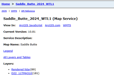

When just looking at (which appears to be the Hillshade layer(s) in question):
It shows as a tiled MapService with Min LOD (Level of Detail) = 12
and Max LOD = 17.

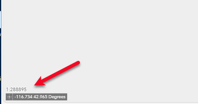

If I load that into the old WAB to easily see the zoom level, you see that the service is becoming visible at LOD=12:

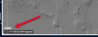

then turns off once we zoom past the MAX LOD set in the service:
So, doesn't look like it is related to the basemap after all.  It is just drawing as per the LOD/tile scheme settings.
