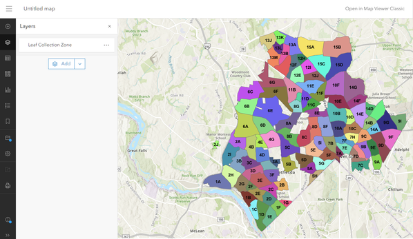

Hi Mark,
You can definitely add the leaf layer to a map.
Click on that link in your post and then scroll down to:
And Click on "Leaf Collection Zone".
That will take you a new page. Copy the Url which is this:
 https://www7.montgomerycountymd.gov/arcgis/rest/services/DOT/leaf_collection/MapServer/0

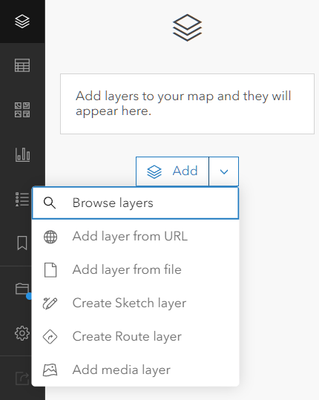

Now open a new or existing map and go to layers and add a new layer from an Url and paste that into the spot, et Voila!

MiguelParedes
Greetings @MarkDoehnert
As @RonaldHaug suggests, you can add it as a Feature layer from the map service by using the "0" index the REST endpoint.  If you are planning to use the Feature layer in other maps, you can add it to your Content by clicking + New item > URL, and then providing the URL https://www7.montgomerycountymd.gov/arcgis/rest/services/DOT/leaf_collection/MapServer/0
You should then be able to add it to any existing or new maps.

MarkDoehnert
Thank you Ronald - I had no idea the content of that entire page was the layer!  So I had no idea that was the URL to copy - it worked perfectly!!
