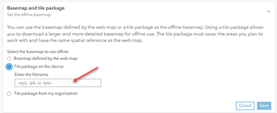

If you just want to use it in field maps, you could create a map tile package on your computer, and then you could go into field maps and tell it you are using a custom basemap.
screenshot from field maps:
Then you can put the files on your mobile device and can "sideload" it as a basemap" without having to publish it in AGOL. so that should not use any credits, as long as when you package it in Arc Pro you uncheck the box that says package it online, and pick a location on your computer to package it instead.

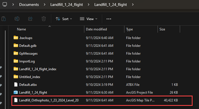

2. Open up file explorer and check to see that the tile package is located where it was created, also check the file size to be sure it isn’t too big.

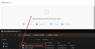

3. Login to ArcGIS Online, and click New item, then drag and drop the file into the pop-up window.

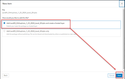

4. Click to Publish your raster tile package as a hosted layer:

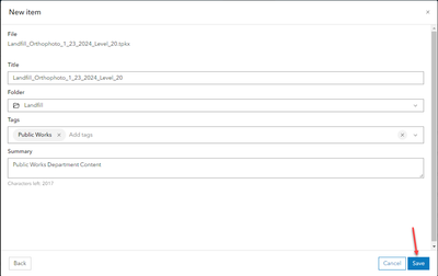

5.
Fill it out as follows, and be sure to save it inside the Landfill folder then click Save:

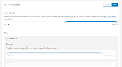

6. Set the Visible Range and also check the box to allow it to work offline then wait it to finish saying “processing tiles” then click Save.
