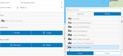

@Philip_Ruthstrom Are you using ArcGIS Vector Tile Style Editor? I see more fonts:

As stated in the submission, I am using the Vector Tile Style Editor, yes. And the only fonts available are those shown below.
PatrickKielty
Not sure if you ever figure this out, but we found that we had to publish the Vector Map to AGOL with all the different varieties of fonts we wanted to use. So our Vector Tile has about 30 different fonts available. If you only exported/shared the map with the fonts you listed, that is all you will to style your map.
