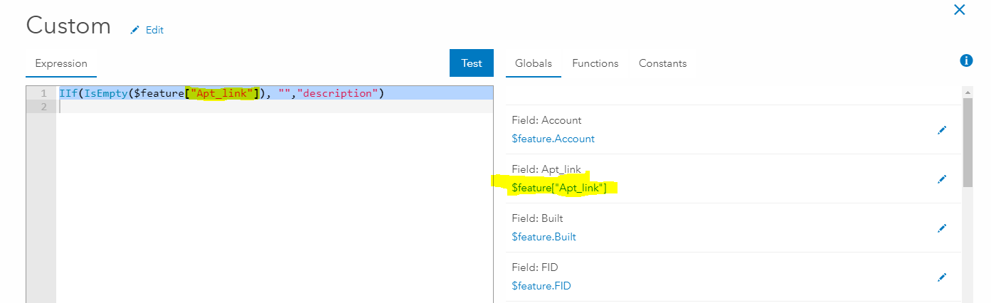

I’m trying to replicate the “Conditional Field Display” as wonderfully noted by Kelly Gerrow et al, https://community.esri.com/community/gis/web-gis/arcgisonline/blog/2017/07/18/conditional-field-disp... with my particular dataset, but running into an issue – possibly with the field name??
Here are the steps I’ve taken:
Step 1. Create an Arcade Expression
IIF (isEmpty($feature[“Apt_link”]),””,”Description”)
(Instead of $feature.description format specified in the instructions, I'm using [" "]...could this be the problem??)
Step 2. Configure Customer Attribute Display
{ownername1
{expression/expr0}  {Description}
Both the expression/expr0 and Description are lined to the "Apt_link" field in my dataset.
Here's a link to my webmap:
http://arcg.is/10CLrz
Any help would be greatly appreciated!!
Pete
PeteCoventry3
Deactivated User
Turns out that I had a space (" ") in my records causing the expression not to work correctly.
Thanks to Kelly for all her help!!

PeteCoventry1
Hi Kelly!
I'd like the popup to display "Apartment Link"  only when the url is available. "Apartment Link" would obviously be linked to the URL in my attribute table.
Thanks!!
Pete
PeteCoventry3
Deactivated User
