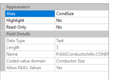

Dear @SLH --
Your CondSize field has a coded domain applied to it.
This means that what is displayed in a table and in the attribute window and the identify tool is not the value in the field, but the description from the domain. your values 43, 37 are codes in the domain and values like 1/0, 2/0 are descriptions of those codes. This is very handy as it allows you to efficiently store and handle codes in fields - but expose easily understood text descriptions while editing and displaying the data.
To see the domain, go and look for it by right clicking your geodatabase where the feature class lives and select Domains and find the ConductorSize domain and look at its codes and descriptions.

SLH
Hi, Dan,
I double checked the field and copied it as below. It is text. And also I tried to export it as txt file and excel file. It is same issue there:  it gave me the different strings such as r'43', r'37', etc
Thanks
Eddy H.
