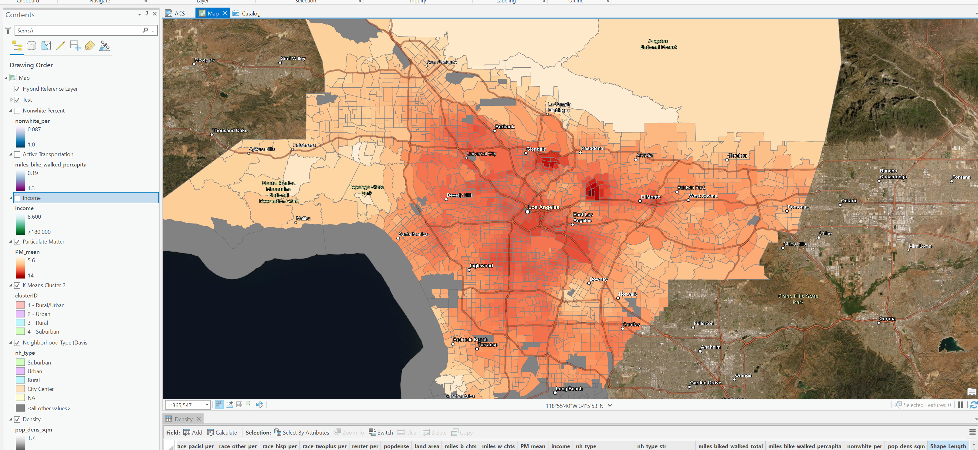

This is what the data looks like in Pro:

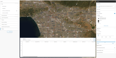

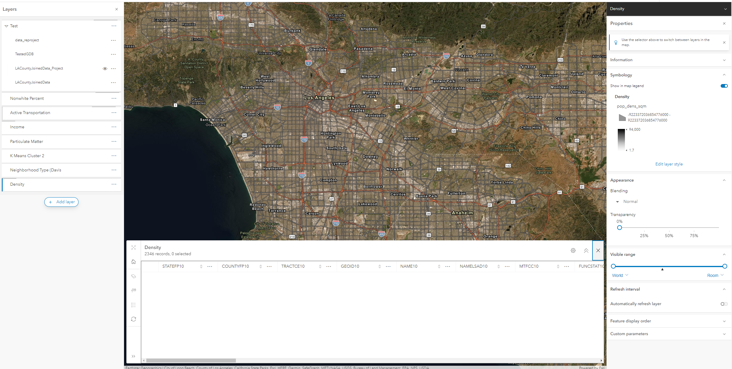

Here's what I get on AGOL:
