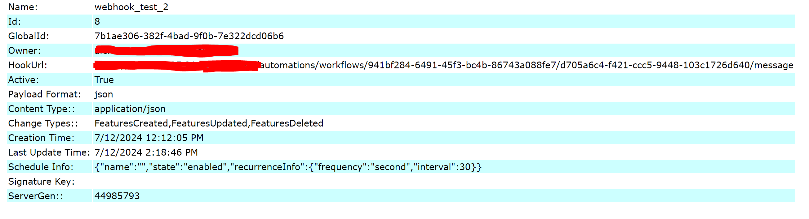

Hi,
Hopefully someone may be able to help. I have a hosted feature layer, created from a Survey123 form. I have tested ingesting a webhook response directly from Survey123, using FME Flow. This works correctly, as expected.
However, when attempting to set up a webhook directly on the feature service, I get no response when adding or editing a feature.
The feature service has all editing & editor tracking enabled, with "Enable sync" turned off. I have admin rights so that shouldn't be an issue, and the FME Flow URL works directly from a S123 webhook, so it's unlikely that's the issue.
Does anyone have any suggestions as the problem, or anyone experienced anything similar?
