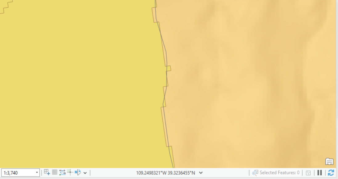

I recently posted about getting help with code that returned a Y/N value based on if two polygon features intersected. The code worked great, but the two layers don't share perfectly aligned boundaries. One has a more "jagged" boundary that is visible when zoomed, causing it to flag as an intersection when it is not supposed to be. Any advice on a workaround? Would the "within" or "contains" function be more useful? Is there a way to buffer the boundary so that the slight mis-alignment doesn't produce an incorrect result?

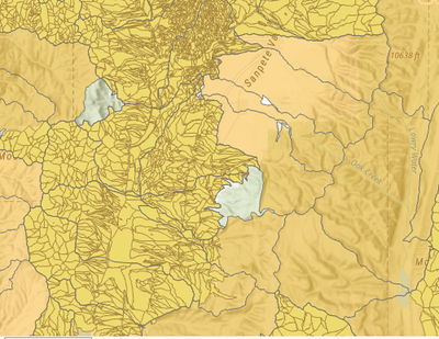

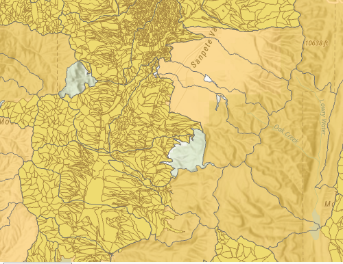

The larger polygons in orange are watersheds, and the smaller green polygons are impaired catchments. If there is even a single impaired catchment within a given watershed, I want to populate the field "is impaired" with "Y", or "N".Large watersheds and small catchments.png

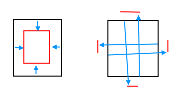

Null geometries are created when you try to buffer too much. You probably have small polygons in your fc. In these cases, the buffer of one side would end up on the outside of the polygon on the other side, resulting in a null geometry. This is difficult to explain, so here is a quick sketch:
On the left, a polygon (black) and a negative buffer (red) with appropriate buffer distance (blue).
On the right, the buffer distance is too big for the polygon, so the buffer's sides would end up outside of the polygon, creating a nonsensical geometry (not saying that the buffer algorithm actually works this way, just as a concept).
tl;dr: use an appropriately small buffer size or exclude polygons with small area from the calculation.
