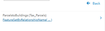

Take a look at the expression FeatureSetByRelationshipName. This will return all related features, and individual features and attributes can be accessed directly through the resulting FeatureSet.

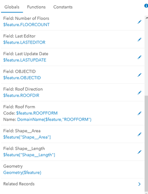

In the Expression Builder, you can see related records at the bottom of the $feature globals:
From there, you can select the particular relation (if there are multiple) that you'd like to bring into your expression.
