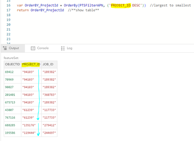

Hi Esri community,
I am trying to use OrderBy on a String field.  It appears 5-characters numbers are being ordered before 6-character numbers.  Which is not ideal.  I can't change the Project Id field to a number as the database sometimes uses a letter at the end.
Does anyone have a clever arcade trick to order by numbers that are stored as a string?  Ideally, I want it to return 135176 --> 612239 largest to smallest.
Thank you!

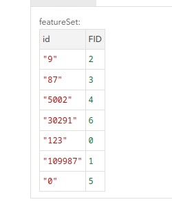

Here's a pretty safe approach: keep the numbers as strings, but prepend "0" characters. Here's a made up feature set with the same problem. Sorting by ID gets me this:

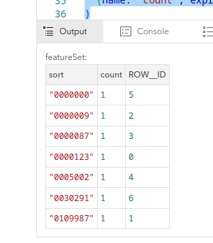

var sql = `
CASE
WHEN char_length(id) < 2 THEN '000000' + id
WHEN char_length(id) < 3 THEN '00000' + id
WHEN char_length(id) < 4 THEN '0000' + id
WHEN char_length(id) < 5 THEN '000' + id
WHEN char_length(id) < 6 THEN '00' + id
WHEN char_length(id) < 7 THEN '0' + id
ELSE id
END
return groupby(
  fs,
    {name: 'sort', expression: sql}
  {name: 'count', expression: '1', statistic: 'count'}
It's not exactly elegant, but the results:
