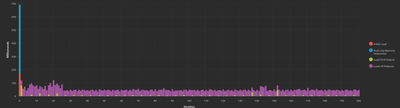

I made a Data Expression once to test this sort of thing! I decided to open it up and make some adjustments.
I'm pinging all features of the World Countries (Generalized) layer from the Living Atlas. I had it do mostly the same steps as you, timing how long to initially load the FeatureSet, then how long to load the first feature and to load all the features. I should note, I'm not timing individual feature loads in the last step, just how long it takes to do a for loop on all features.
I set it to repeat the process 200 times and push the results to a new FeatureSet so I could look at it.
There are some spikes, but the pattern is pretty clear. Here are the median values:
StepTime (ms)
Load FeatureSet412
Load First Feature173
Load All Features
46
So it does seem like once that first feature is loaded, doing anything else with additional features is nearly instantaneous.
Watching the Network tab of the browser, there's only traffic on the initial ping to the FeatureSet. Iterations 2-200 still take time, but as the query is the same, the dashboard uses the cached response from the first request. The individual features come in all at once, and I would guess that you are right, the features are just being held in the browser's memory and being accessed individually there.

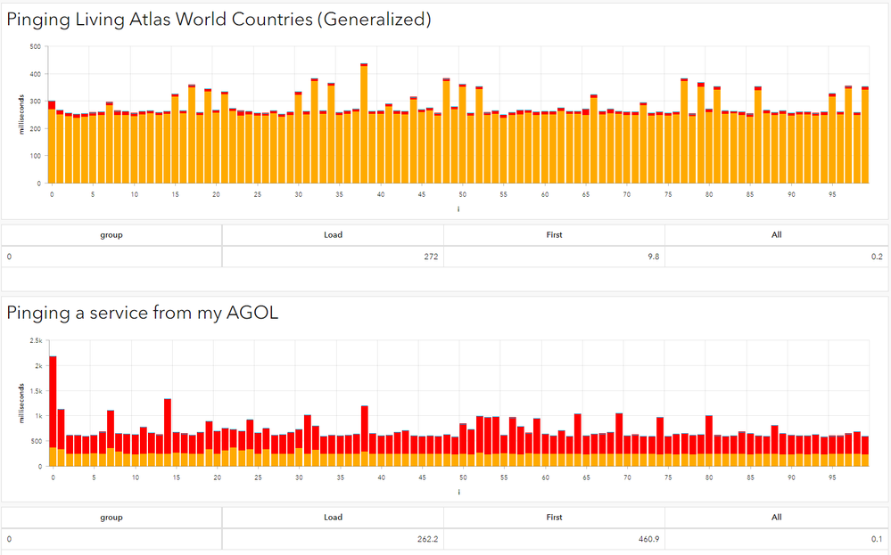

Pinging the World Atlas is a good idea and raises two other interesting points:
If you load a layer form the Living Atlas in the Arcade Playground, the FeaturesetBy* function returns instantly.
Loading the First() feature takes much less time for a layer from the Living Atlas compared to a service from my AGOL:
The time to load the layer is approximately the same. But the expression loads the First() feature from the World Atlas in 10 milliseconds, and from my AGOL in 460 milliseconds. That's a somewhat extreme difference.
