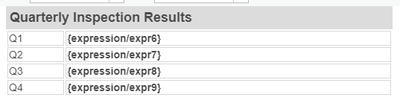

I would like to display a single attribute for each quarter in the pop up. Something like this:
Where each expression returns the inspection result. My thought was if I could evaluate each point's inspection dates to see if any fall within a range (or quarter), I could then return the result that was recorded from that particular date. I hope that answers your questions. I appreciate your help!
