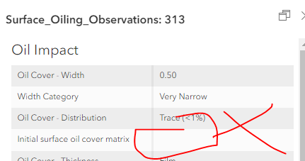

I've got stuck and I can't work out why.  My workflow is as follows - a user in the field captures some data and I want to use Arcade to classify that data to create improved visuals.  I've written a When statement which appears to be working in the sandpit but once it goes to the map, the value fails to materialise....
LiamHarringtonMissin_1-1662459123553.png appears to work, but...LiamHarringtonMissin_2-1662459407399.png
Nothing appears in the popup?  I should be getting a VL at the very least.

JohannesLindner
MVP Alum
Your variable is named width_cat, but you're using width in the When() function.

LiamHarrington-Missin
Well now I feel stupid... Thanks @JohannesLindner
Liam
JohannesLindner
MVP Alum
Ha, that's no reason to feel stupid! I've misnamed or misspelled variables so often that it's one of the first things I look for, now...
