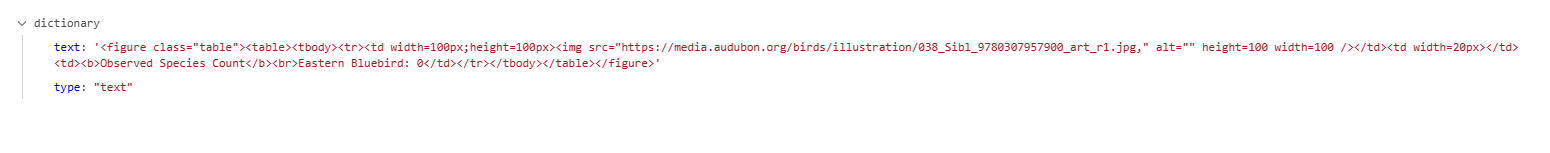

I'm using an Arcade expression in a popup to display observed bird species counts along with an image for point feature layer. The code runs without errors in the Arcade editor. The image is also loading correctly from the "Image_url" field in pop-up.  However, the species count part is not showing up at all. Instead, I only see the fallback message "No Species Data Available"
