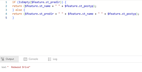

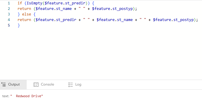

Hello,
I am trying to create an label expression to show street names, where if there is not a direction prefix (st_predir), then it ignores it and creates the label with the name (st_name) and street type (st_postyp).
It mostly doing what I want, except blank space appears at the beginning of the label when the st_predir field is empty (see below).
Thanks!

What about around line 4?

DanPatterson
MVP Esteemed Contributor
throw the whole expression inside a "trim" perhaps

dsinha
Thanks @DanPatterson, but it didn't work. 🙁

dsinha
Thanks @DanPatterson . That did it! 😊
