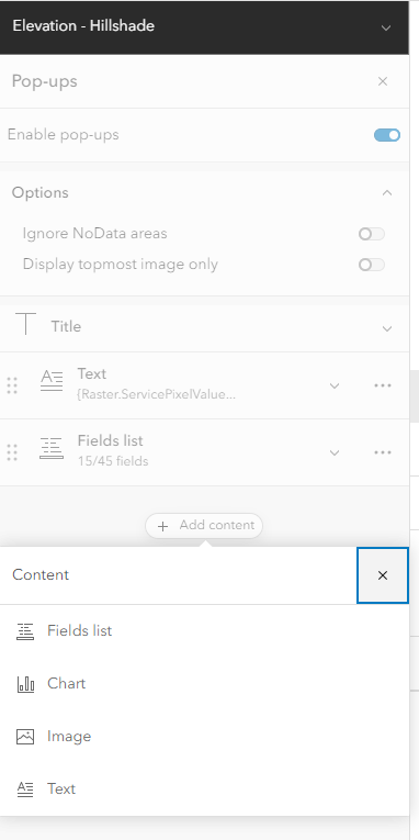

Is it possible to use Arcade attribute expressions with an imagery layer in Map Viewer? I'm trying to configure the popup for the USGS 3DEP layer to show elevation in feet. I can get it to show the raw pixel value in meters, but I'd like to do a simple conversion to display feet.
I don't see the option in the popup for the layer, and I don't see anything in the documentation that specifically says attribute expressions aren't supported for imagery layers. Maybe I'm overlooking something.

Hi @jmaxwell_braun ,
Currently Arcade is not supported on Imagery Layers. However, this is something that others users have also asked for and is under consideration for a future release.

Please consider adding this. This is needed for unit conversion
