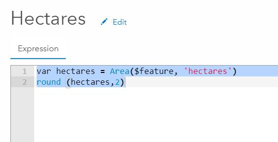

Hi All, I have a calculated field expression in a hosted feature layer and when I attempt to export to CSV from a WAB attribute table, the CSV comes up blank in this calculated field. Is this expected behavior?
Some screenshots below to help depict the issue I am finding

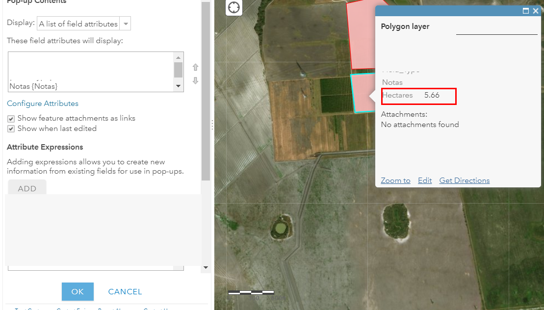

It shows up in the map pop up and the attribute table without issue:

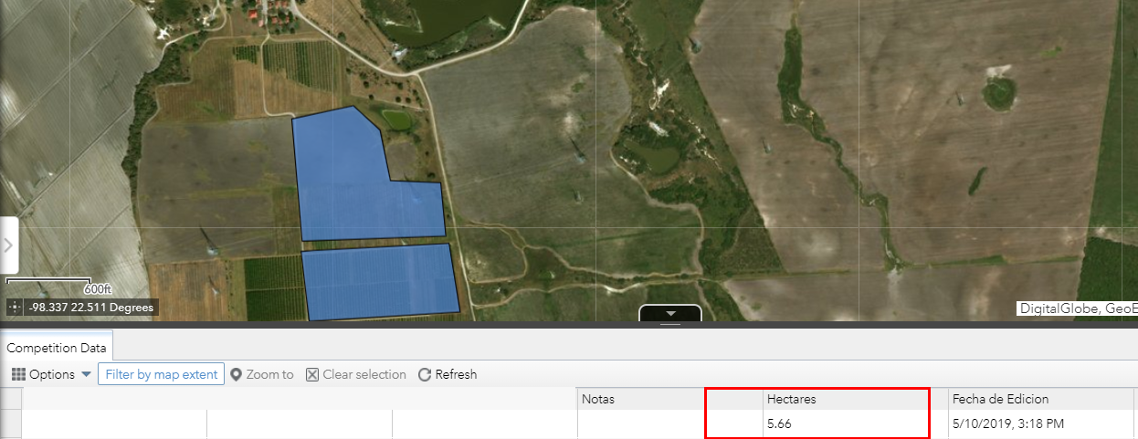

I have created a web app using web app builder and the attribute table widget still shows this calculation

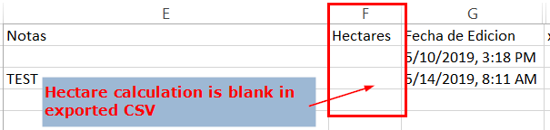

However, when i go to "export to CSV" from the WAB Attribute table widget, the CSV comes up with a blank value

In that case it has limitations. You will not be able to use this "virtual field" in many widgets and as you noticed it will not end up in the exported (although it is strange that the field name does appear in the export).
