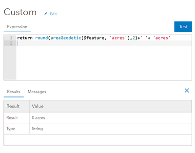

When I use the AreaGeodetic Function as ($feature, 'acre'), it returns a result of 0. I'm certain I'm missing something silly. I tried it in other maps and it works.

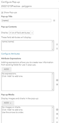

This is what the Configure pop ups looks like for the polygons:

Thank you, however it still returns 0. Here is a screen shot of the test:
MarkBockenhauer
Try it with a polygon feature in your map, that you know has an area.   The  %feature test result is for the feature with OBJECTID 1 (or lowest), is there a chance your OBJECTID 1 polygon feature is not a good one?
