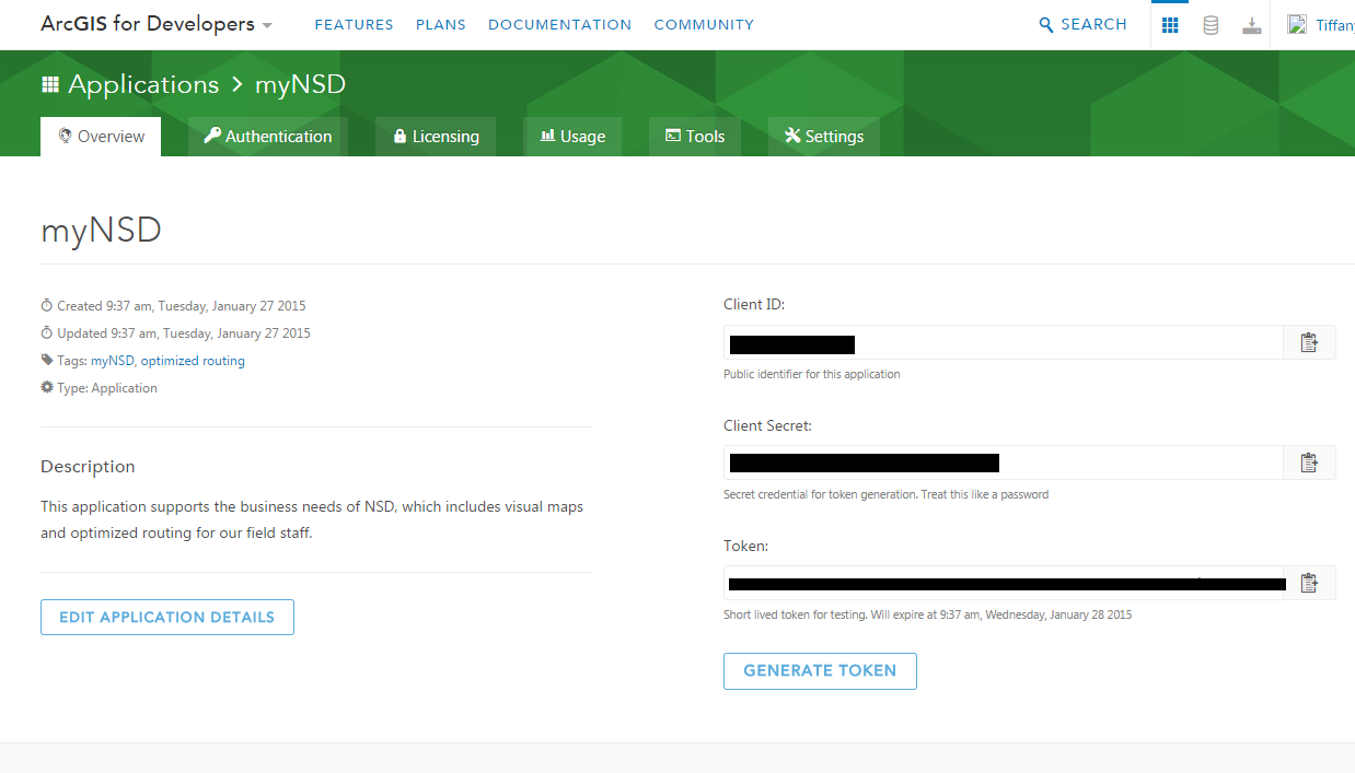

I was just curious on how to address this potential (and very likely) situation...
When AGOL applications are linked to individual users:
And that individual user leaves the organization and there is no replacement user, wouldn't it be better to create a "named user" like NSD_Apps to accommodate the movement of people in organizations?
