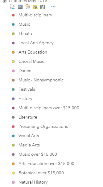

Is there a way to change the order of legend item in an AGOL map?  I point back to this map in a dashboard so I'm trying to get the color assignments consistent between the the two applicatons.
If I could alphabetize the items of the legend as operations dashboard does (in charts) then my points will be color coded with my charts....

Click on the "Change Style" icon and click on the Options button under "Select a drawing style". Move your mouse over the three vertical dots on a item to change the mouse icon from a pointer to a move icon, then click on the item to drag it to a new position in the list.

Thanks Ken-  I've got about 25 different classifications, and was hoping there was to nifty sort tool somewhere....
