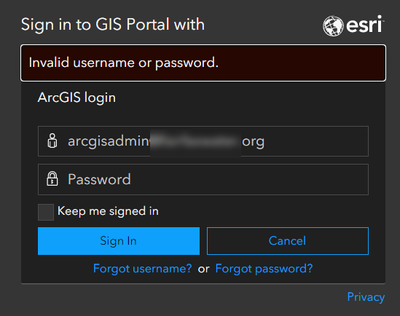

@BenTurrell & @DanSenner have either of you actually used this function? Although I understand what it's supposed to do I can't get it to work.
  1. I have my portal URLs entered into the setting
  2. have registered items from AGOL into these portals, choosing not to include credentials.
  3. My understanding is this will allow members of my portal to use their enterprise logins to access the secure AGOL content when viewing it from these portals.
  4. However, when accessing the content I'm asked to log in to AGOL. When using portal SAML credentials I can't do so....
