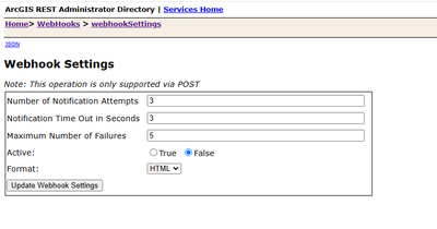

Hi All,
I have an ArcGIS Online Feature Service with 2 webhooks. I created these manually using the REST admin web interface. For each I set "active" = true. They work fine... until they don't
After some time these are being reset to false. This has occurred several times now.
What are known scenarios which would cause an AGOL feature service webhook's "active" status to change  from true to false?

KevinHibma
Check the Notification Status endpoint for the webhook. I suspect your webhooks are failing to send to your receiver and are being automatically disabled.
If you check the settings in your root, you can see how many failures will trigger the disabling.
