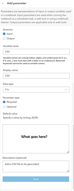

No info on script tool parameters to be found here: https://doc.arcgis.com/en/arcgis-online/get-started/get-started-with-notebooks.htm
Generally speaking, how does a parameter work? Is it like a Pro script tool parameter? How do I fill it out? For example, for Pro you just put arcpy.GetParameterAsText(0) in place of the variable in the script. And then based on the 0 index you fill out the parameters for the tool.

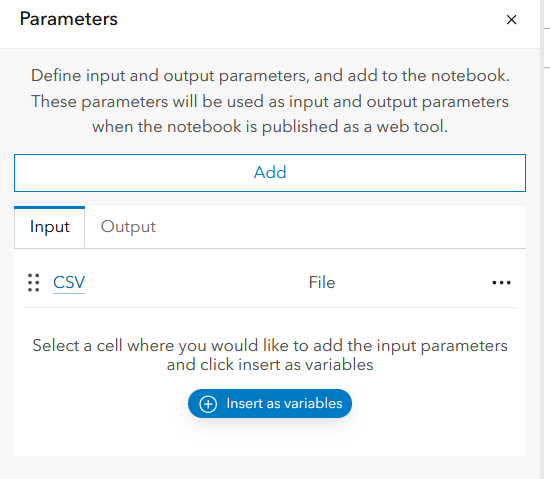

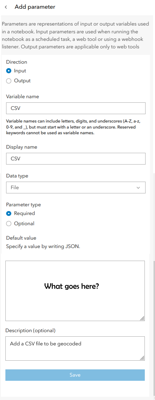

I have a short script I'd like to make into a tool to ultimately be used in ExB. It geocodes a CSV file. There should only be two variables concerning the user: the CSV in file and the CSV out file. Once you fill out the Add parameter pane and enter something in the Default value (?) box you can save. It then gives you the option to insert the variable. Not sure where to insert it?
csv file > df > gdf > shp
