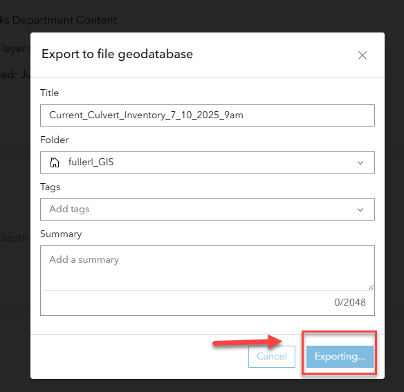

When exporting a large feature service with many attachments to a file geodatabase in ArcGIS Online, there’s no indication of progress or estimated time remaining. After about 15 minutes, I’m unsure whether the export is still processing or has stalled. Is there any way to check the status or confirm that it’s still running?

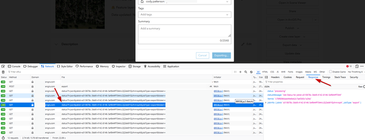

You can use the f12 console and the Network tab to view progress, clicking on a status response will show you if it's still processing:
If you'd like, I'd suggest making an Idea post about getting some sort of better visual indicator, as this is not the best!
