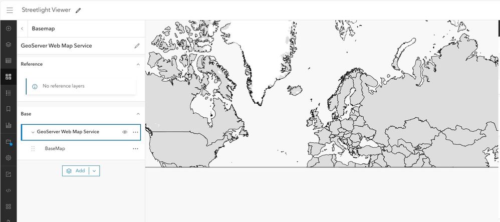

I tested your url as a basemap using Web Mercator 3857 and it works nicely as shown in attached screenshot.BaseMap_3857.jpg
So my conclution is that there might be some issue with this data when it is used as a basemap and it is worth to have a chat with local Esri support. However there is a decent workaround and it is forcing the service to work in certain defined projection.

Thank you very much, the workaround from the other post worked!  This dataset uses the “VTTS_3995_WGS_1984_Arctic_Polar_Stereographic” projection, which is EPSG:3995. I've attached a screenshot of what I put in the "Add Layer" window that allowed me to use this dataset as a basemap in case it's helpful for others.
