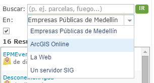

You mean that you are logged on to your organization and when you want to add a layer from ArcGIS Online the option is not there. I think I can reproduce this... If I log on to the organization and create a new map to which I want to add the layer I see the options; My Organization, A GIS Server and the Living Atlas (sorry for the Spanish interface):

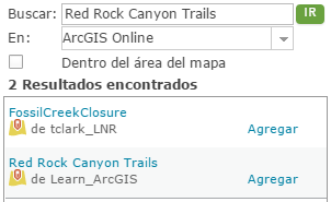

If I log out and try again I see that the ArcGIS Online option appears:
... and it finds the layer:
