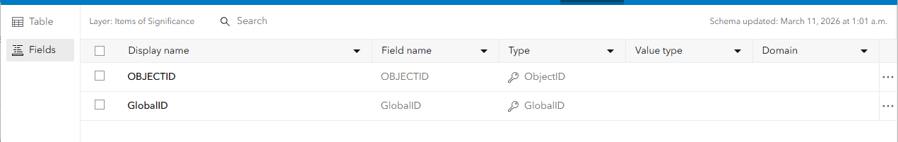

I have an existing AGOL view on a feature layer.
I've added some new fields to the feature layer. Now I want to add the fields to the view. How can I do that? I don't see an Add Field button in AGOL > Data > Fields.
I don't want to delete and recreate the view because there are privileges set up on the view that I couldn't recreate myself because I'm not a GIS admin.

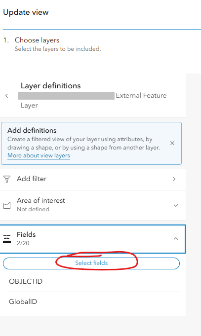

Go through the wizard to choose the layer, then select the fields...
