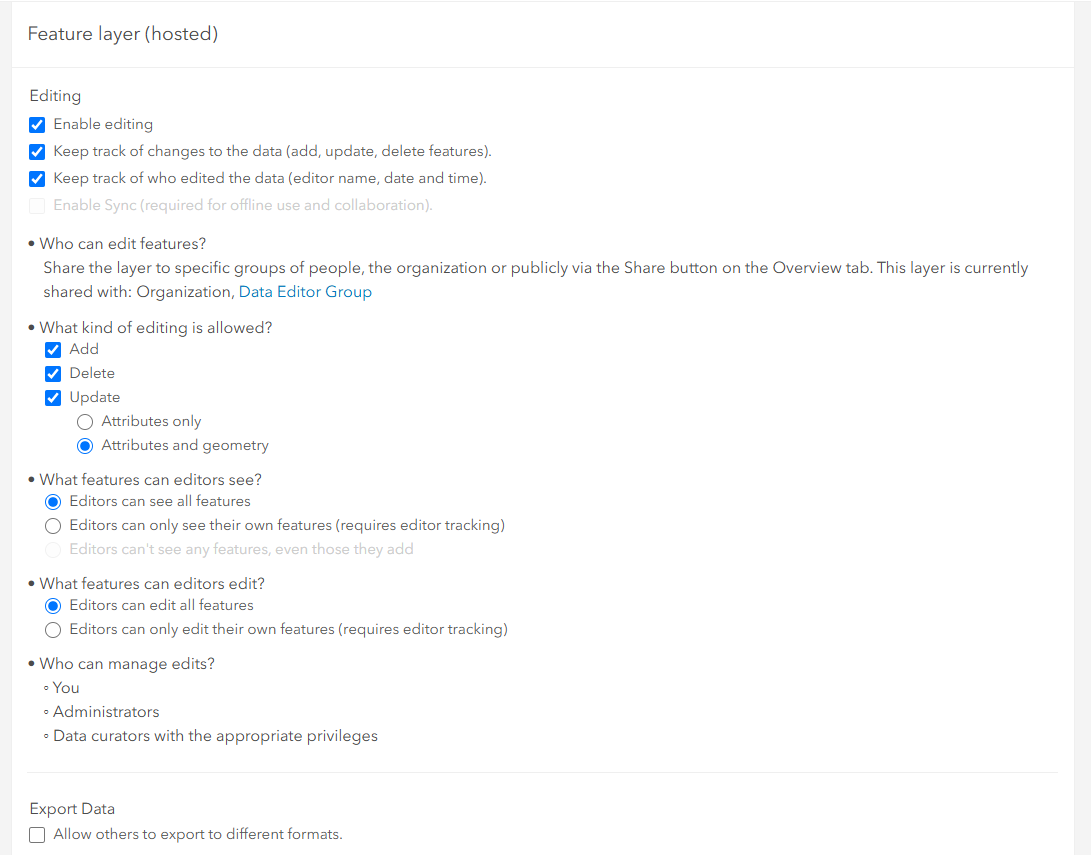

I already checked the settings:
Do you have any idea on how I can do it ?

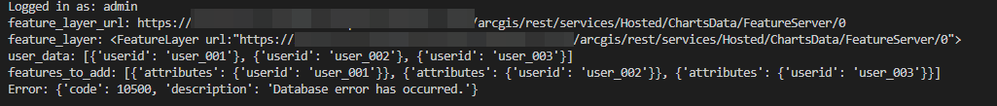

Here's what the prints look like
Seems normal to me, I get the right data

ZiqingYu
what do you see if you print the variable 'feature_layer'?
DavidPike
MVP Notable Contributor
I'd recommend printing everything out and just try a simple hardcoded input to test.
HamzaMerini
