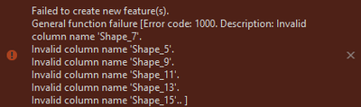

so i'm trying to add a new feature to an AGOL feature service using the Apply edits REST API the feature service is a polyline and i get this error:
  "addResults" : [
      "objectId" : null,
      "uniqueId" : null,
      "globalId" : "5ED16305-D978-4C4F-951F-B87FC1479927",
      "success" : false,
      "error" :
        "code" : 1000,
        "description" : "Invalid column name 'Shape_5'.\r\nInvalid column name 'Shape_7'.\r\nInvalid column name 'Shape_9'.\r\nInvalid column name 'Shape_11'.\r\nInvalid column name 'Shape_13'.\r\nInvalid column name 'Shape_15'."
i have even queried an existing feature and tried to re-add it using its JSON and get the same error

strangely i get the same error when trying to manually create the feature in a webmap, its as thought the indexes are corrupt on the feature service

StuartMoore
get the same error in Pro as the WebMap when trying to create a new feature

ive exported it to an FGDB and it worked fine, just ran the check geometry tool in Arc Catalog and its highlighted 3 features with errors:
WARNING 000442: short segments at 29505
StuartMoore
i've deleted the 3 features with errors and rebuild the indexes again but still get the same error

Were you able to find a solution? I am experiencing the same problem. This appears to be correlated with a modification of the Definition properties.
I updated the Types property from the admin interface and this issue started.

the only solution i found was to create a new feature service, i didnt want to try re-publishing the original service
