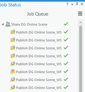

JustinJohnston
I had done that before opening in Online.  All jobs were checked.
JustinJohnston
I deleted the scene from Online and tried again watching progress of jobs.  One of the layers failed to cache the attempt.  Not sure what caused it?
JustinJohnston
I saved, restarted ArcGIS Pro, deleted everything from Online again, and reshared.  Back to where I was with the X and Y dimensions of the cylinder from Pro being lost when shared Online.  Everything has 1.5m again.  I guess if I want the bollards, I need to make multipatch cylinders instead.  Point features with the system 3D model just aren't working as expected.
