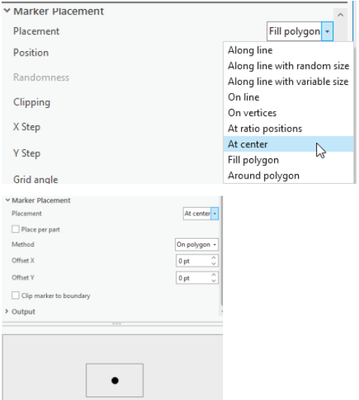

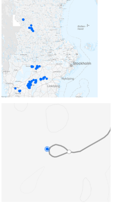

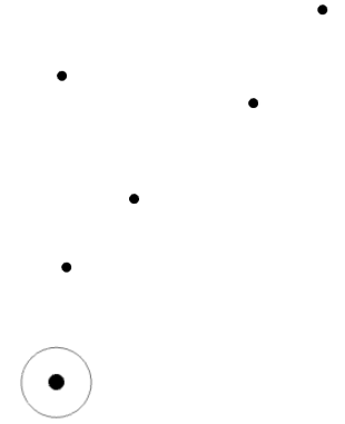

I got a workaround from Esri Sweden that works well for us!
1. Open Format Polygon Symbol for your polygon layer and choose Properties and Structure (wrench icon).
2. Delete Fill Symbol Layer (you should still have a Stroke layer).
3.Add Marker layer from Add symbol layer.
4.Go to Layers and pick a symbol for your Marker, choose color, outline and size of your choice.
5. Under Marker Placement and Placement choose At center.
6. If you have polygons in your map they will appear with a dot. If you zoom in you can also see how the polygon outline appears.

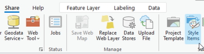

Log in as Portaladmin to your Portal and add a 2D Web Style library to your Portal.
Prepare your symbol in ArcGIS Pro on a random polygon layer. Make sure the layer's name is the name you would like for your symbol in the Portal. Save your .aprx.
Note: You need separate projects for points, lines and polygons.
Note: Give points an outline to make sure there is an option to change the outline colour in the Portal.
Make sure you are logged in to the right Portal as Publisher
Save you symbol as a style item by chosing Style Items on the ribbon menu Share.

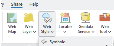

On the ribbon meny Share choose Web Style and you newly created Style.
In Share As Web Style give the item a Name, Summary, Tags. Choose 2D as Style Type and choose where you want to publish it to Share with your organization and the group  Web Styles. Analyze and Share
