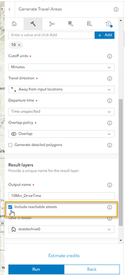

Hi @CarynAshbay,
Does turning on the Include reachable streets parameter help achieve what you want?
It will generate a line layer that contains all the roads that were used to create the travel areas.

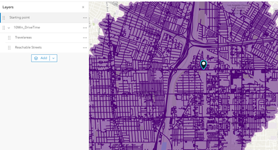

For example, the purple lines here represent the accessed roads
