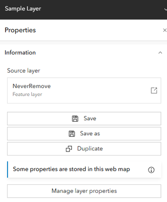

If the map doesnt contain a popup info the layer item popup will be used. If you want to pull in the layer item configuration you can pick to use the feature layer item as the source to drive this. You can see where the popup is stored under the layer properties panel click on info button above Manage Layer properties

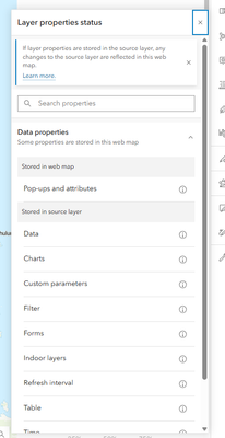

You will probably see something like this to help you see what is coming from the map vs. the layer item

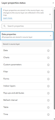

Clicking on Manage layer props button will show you an option to reset to source which will point to the layer item configuration and remove the configuration in the web map. *this is only persisted until you re-save or save as the web map.
You can go back to that "some properties" info button and will see the updates to where things are stored.
