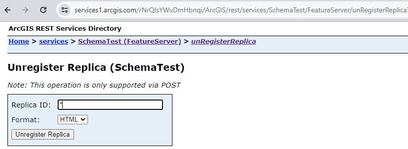

As an aside - and it doesn't always work - you can enter * into the unRegisterReplica option for a feature service e.g. https://services3.arcgis.com/AkUq3zcWf7TVqyR9/ArcGIS/rest/services/SERVICE_NAME/FeatureServer/unRegisterReplica and that will try and remove all replicas.
TylerMcGarrity
As an aside - and it doesn't always work - you can enter * into the unRegisterReplica option for a feature service e.g. https://services3.arcgis.com/AkUq3zcWf7TVqyR9/ArcGIS/rest/services/SERVICE_NAME/FeatureServer/unRegi... and that will try and remove all replicas.
This worked for me. Thank you!

TylerMcGarrity
Hello @LukeGilner1,
No specific code, you just enter an asterisk and click on Unregister Replica:
LukeGilner1
@TylerMcGarrity
Awesome!  Thanks for the picture.  Worked for me!
