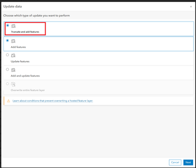

Yes - this option is definitely needed. Requiring Pro for doing a simple truncate and reload of data seems overkill, given the other options available via the "Update data" option in ArcGIS Online.
It's a pretty common requirement to re-load a new set of data without republishing (overwriting) the service.
The dialog just needs an additional "Truncate and add" option (see below example).
Or perhaps a check box after selecting the "Add" option to specify a truncate prior to the add.
