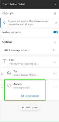

AndresCastillo
There is a post by @rdbutger where he shows he used Arcade  in the web map popup to bypass this automatic behavior.
Here is my sample code:
https://community.esri.com/t5/arcgis-online-questions/arcgis-online-popup-appending-rel-quot-noopene...
This allows me to change the page in-place, instead of opening a new tab.
var baseurl = 'https://www.something.com/route/'
var code = Lower($feature.ColumnName)
var train_stations_public_page = Concatenate([baseurl,code])
Console(train_stations_public_page)
var train_stations_public_page_link = '<strong><a style="color:#01507b;text-decoration: underline;cursor:pointer" target="_self" href="' + train_stations_public_page + '">Station Details</a></strong>'
Console(train_stations_public_page_link)
return {
	type : 'text',
	text : train_stations_public_page_link
