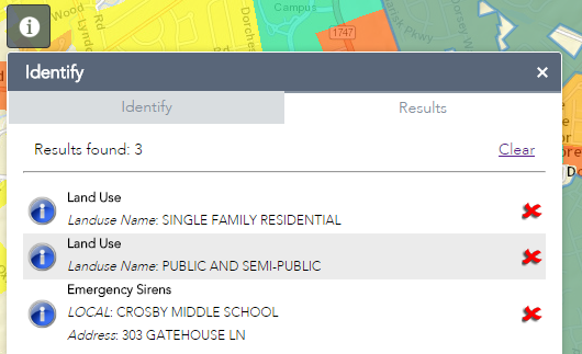

My customer required their users to quickly view all the features and constraints underneath their planning applications. The planners want a quick summary in one windows view, in which they can scroll, and copy and paste the results quickly to Word or Notepad. There seem to be no out of the box way of doing this. The closest is the Query widget, but you can only run query on one layer at a time, customer has 60.
There is a similar functionality done by Robert Scheitlin Identify Widget Version 2.1 -  07/20/2016
You can configure multiple layers to be interrogated and the results are shown in one window:
It would be great to bring this functionality to ArcGIS Online, either in update/addition to pop-up functionality, ability to query all layers in Query widget or a new widget like the Identify Widget by Robert.
