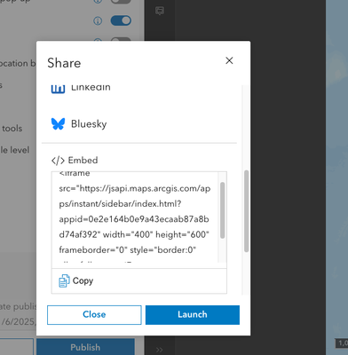

KellyHutchins
You could use an app like the Sidebar instant app to add the scalebar, active panel and layer list then add this to an iframe?  After creating the sidebar app you can get the iframe code in the embed section of the publish dialog.
Screenshot 2025-11-06 at 9.21.08 AM.pngScreenshot 2025-11-06 at 9.21.08 AM.png
