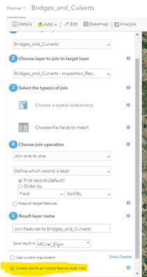

Hello
The new Map viewer is missing the ability to output a hosted view layer when doing a join.
This function works in map viewer classic.
Please enhance the join analysis tool to include this function.
Thanks
Hosted view layer join.pngclassic join tool

Hi @MattyMaps,
There's now a new way to create a hosted feature layer view from a join, located on the item details page. You can check out the documentation here and this great blog post about the new method.
Please try this out and let us know if there's anything that is not supported for your workflow.
