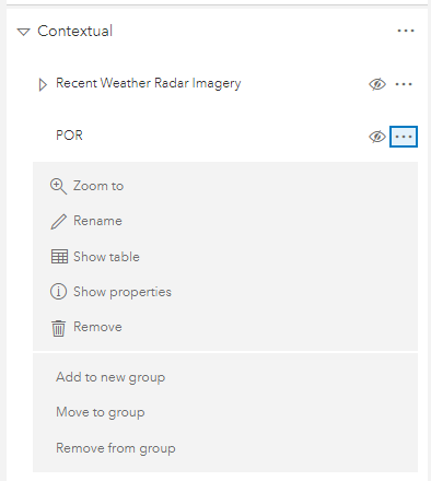

DavidWittmann
@RussRoberts Oh, interesting! I work mostly in the ArcGIS Enterprise 10.9.1 version of the Map Viewer so I only see the following options for grouping:
All of these grouping options pertain to those top level groups and not nested group layers.
It's good to hear that they have been added to the ArcGIS Online version of the Map Viewer. Any idea of when these nested layers will make into into a version of ArcGIS Enterprise?
RussRoberts
looks like enterprise picked it up at 11.0
DavidWittmann
Thanks for looking into that, Russell! This just gives me another reason to upgrade to the latest version of Enterprise.
