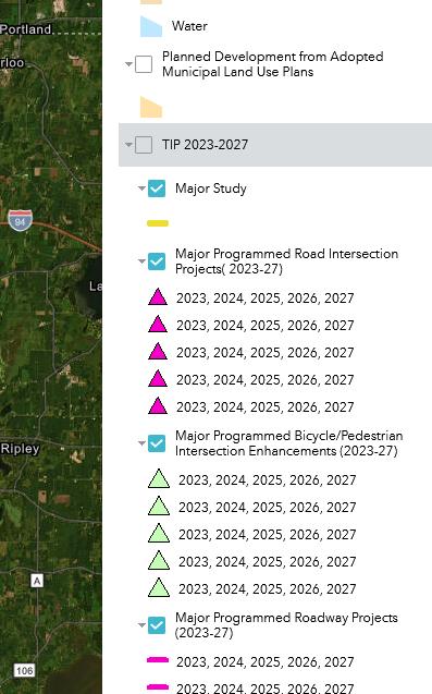

@RussRobertsYou have stated that the ability to group layers will not be coming to the Web App Builder, and I have read that from several other sources as well. However, I have created an app using the Web App Builder that does group several layers together in the Layer List tool.
I added a group of layers to the Map Viewer map used as the source map for the app from the WMS link below. In the Layer list of my app, they are all grouped together and can be toggled on/off with one checkmark.
However, I have unable to get any other grouped layers from Map Viewer to carry over as grouped layers in the App.
Do you know why the layers at the link below are allowed to be grouped in WAB? Is it something that can be replicated? See also the screenshot - the layers are in a group called "TIP 2023-2027".
Thank you! (and to pre-empt the question, in the future I will simply plan to use Experience Builder, but the project I'm working on now is too far along with too tight a deadline to rebuild in EB)

For map services and wms layers they can have a grouping at the service level. You could republish that service you linked above to have that grouping you want. Feature Services or feature layers do not retain this grouping so it wont be present if you add the feature service or the map service at the layer level of the REST endpoint.
The grouping you can create in the Map Viewer that gets saved to the web map is not supported in Map Viewer Classic and other 3.x apps like Web App Builder. These 3.x apps wont read this spec and the layerlist wont be able to display it. There is not a workaround for this case because these apps do not support these latest additions we have made to the web map spec.
