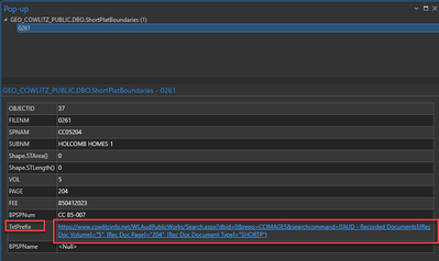

In ArcPro we can populate a column in a feature class with urls and click on the hyperlink to get the link to open.
When we publish the feature class in AGOL and open it in Map Viewer it no longer recognizes that it is a hyperlink automatically.

https://www.cowlitzinfo.net/WLAudPublicWorks/Search.aspx?dbid=0&repo=CCIMAGES&searchcommand={[AUD - Recorded Documents]:[Rec Doc Volume]="5", [Rec Doc Page]="204", [Rec Doc Document Type]="SHORTP"}
What the columns in the table look like:

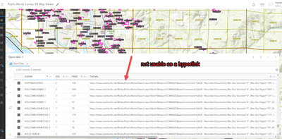

they are stored in a database called laserfiche. For the plats the hyperlink is a column in the table and in map viewer classic and web app builder it recognized that it was a link and went straight to the document.
Here is my web app builder app, the short plats, large lots, subdivisions are all linked in the custom pop up window by using the column name as a hyperlink.
https://cowlitz.maps.arcgis.com/apps/webappviewer/index.html?id=8838029e308e49df9bab1bd6ab89b27a
It doesn't work in Map Viewer, but if I copy and paste a hyperlink from the table into a web browser then the link will go to the correct document.
All I had to do in web app builder is make the txtprefix column a hyperlink in the pop up window and it would open the pdfs. That won't work in the new map viewer.

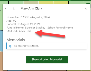

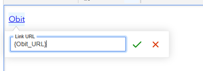

In ArcGIS Online (AGOL) I have maps & EXBs for our cemetery. In the layer I have a field for obituaries. I configured it so the URL is stored in that field. Here's how it looks in Arcade:
<div>Obit URL: <a href="{Obit_URL}">Click Here</a></div>
Alternatively, I can add text to the pop-up and hyperlink the word "Obit" to the URL stored in the field, and it works just as well.
The setup is a little different in map viewer compared to classic, but you can still achieve the same results.
To test this, you can search for "Mary Ann Clark," click on her name, and then select "Click Here" under the Obit URL. Here's the link to try it out: https://experience.arcgis.com/experience/a89b4862cc9b4149b8bc791709f24c13#data_s=id%3AdataSource_8-1...

You're app is really cool! I tried clicking on the link but it wasn't clickable: Maybe try testing it in an incognito window to see if it is clickable there? I clicked on Share a loving memorial but it required me to login to my survey 123 account.
Laura
by MVP Regular Contributor
Ah, it seems that if I refresh the page, the link becomes clickable. This applies to both the arcade and the text in the popup. Kind of weird behavior, though.. Try refreshing on your end and let me know if it behaves the same way. I wonder if it is the same on your applications as well? I was finally able to get into yours and see a list of the documents to look at! It should be allowing that in new map viewer. What does your configuration look like?

My hyperlinks don't show up at all.
I cleared my cache and closed google chrome and searched for Mary Ann Clark again and the link showed up the first time, and the survey 123 app is working now.

I met with ESRI tech support and they filed this as a bug.
https://my.esri.com/#/support/bugs/bugs?bugNumber=BUG-000173571
"The URL added to a text in the pop-up is truncated when there is a curly bracket '{}' after the equal sign in the URL."
