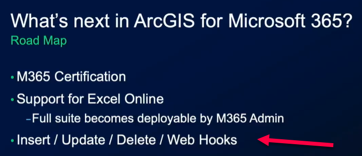

At the latest Dev Summit, Sean McGinnis shared that ESRI is building Power Automate connectors that target Feature Service actions (Insert, Update, Delete). Pretty exciting!
"...We've worked with that team [feature server] to extend the information that is returned from a delete inside the webhook." (link to presentation)
Can anyone from ESRI talk about when this is expected? @ShanonLoughton @SeanMcGinnis

@PhilLarkin1 The v2 ArcGIS Connector in Power Automate is currently in the Preview Region. The Power Automate or M365 Admin can create a new region, and point it to Preview if you want to access it today.
We are in the final stages of certification with Microsoft to get v2 into General Availability and also into GCC. We expect this to take 3-4 weeks from today.
@SeanMcGinnis is leading this work and will likely have some blogs posted that will guide people through using this action in the connector.
