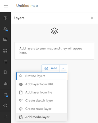

NicoleJohnson
Have you considered adding the images in Map Viewer rather than as an image widget in Experience Builder?
I think another difference doing it this way is that the creases etc. will scale with the map (as if they're georeferenced), rather than staying at the same area of the screen.
