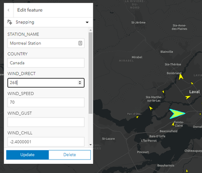

@MollyBurton A similar functionality is now supported in the Editor widget with Visual Variables. You'll be able to use this in apps that use the Editor, such as Map Viewer, Experience Builder, and the Instant Apps.
See this sample: Editor with visual variables data (rotation & size) (codepen.io)
Update the values for existing features for WIND_DIRECT and WIND_SPEED fields. Notice that the symbol is rotated dynamically as the angle value is changed without having to first save the attribute updates. This will make it easier to determine the correct angle rotation visually.
You can rotate polygons and polylines using geometry tools because their vertices get updated, but not for points (the geometry is not actually changed when there is a symbol rotation).
For points, this is only a visual representation based on an attribute - therefore, this visual representation can only be changed by updating the attribute value.
You can set the rotation by attribute option in the Map Viewer when configuring the style for your layer.
