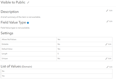

Hello,
Regarding the Citizen Problem Reporter:
I would like to change the default value visible to public from "Yes" to "No" as I do not want to allow the public to see any other user requests until our staff can verify that the requests do not contain any inappropriate content.  It is my understanding that we cannot change the default even when using the Update Definition operation as it fails with the Citizen Reporter Application.
Request:
Please allow us to modify the default value for the Citizen Problem Reporter.
