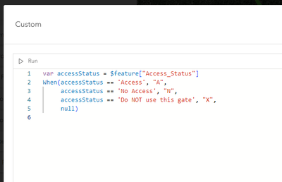

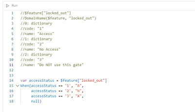

I ended up writing an expression that solved that, but even the Esri support tech didn't know how to accomplish this, and said to create a new field, to which I answered "changing the schema for a label should be last resort", when it should just work.
The frustrating part is that the dictionary works so perfectly in Pro, but it's worthless if you can't leave that environment and it still work.

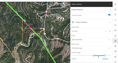

Here's 2 examples of what was needed to make it work with the expression on two slightly different generations of schema.
Here's the results.
