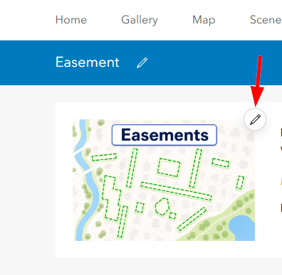

I would like the ability to download a thumbnail I uploaded for an item in ArcGIS Online.
It's common for me to create a custom thumbnail for a layer item and then weeks down the road I will need to use that thumbnail for something else. For example, our enterprise portal or a different item in ArcGIS Online. it would be super useful to just go to an item page and have a button to download that thumbnail. This function could be added to the already existing button for uploading thumbnails.
Yes, I know I should just save the thumbnails locally somewhere, but it's often forgotten and I find it odd that once we upload a thumbnail to ArcGIS Online, you can't get it back out.
Please see screenshot for an example. 

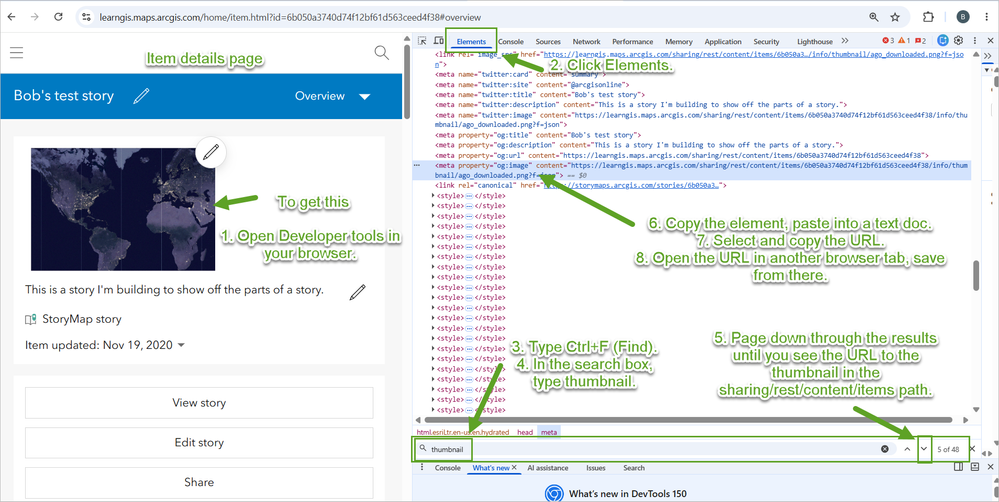

You can find the REST sharing URL for thumbnails from the item details page.
Open the details page.
Open Developer tools for your browser.
Click Elements.
Search for thumbnail.
Page through the results to a rest URL in your org with thumbnail in the path.
Right-click and copy the element.
Paste that into a text doc.
Copy the URL and open it in a new browser tab.
Save the image from there.
