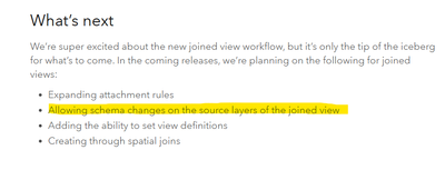

The fact it can be done in the JSON should not be a substitute for a UI. Can someone from ESRI please give an update when we are going to have the ability to update the schema on source layers as stated that we would here (June 2023 ArcGIS online release) When will we see this on the road map?
if there is a technical explanation for not enabling this then please tell us why.
